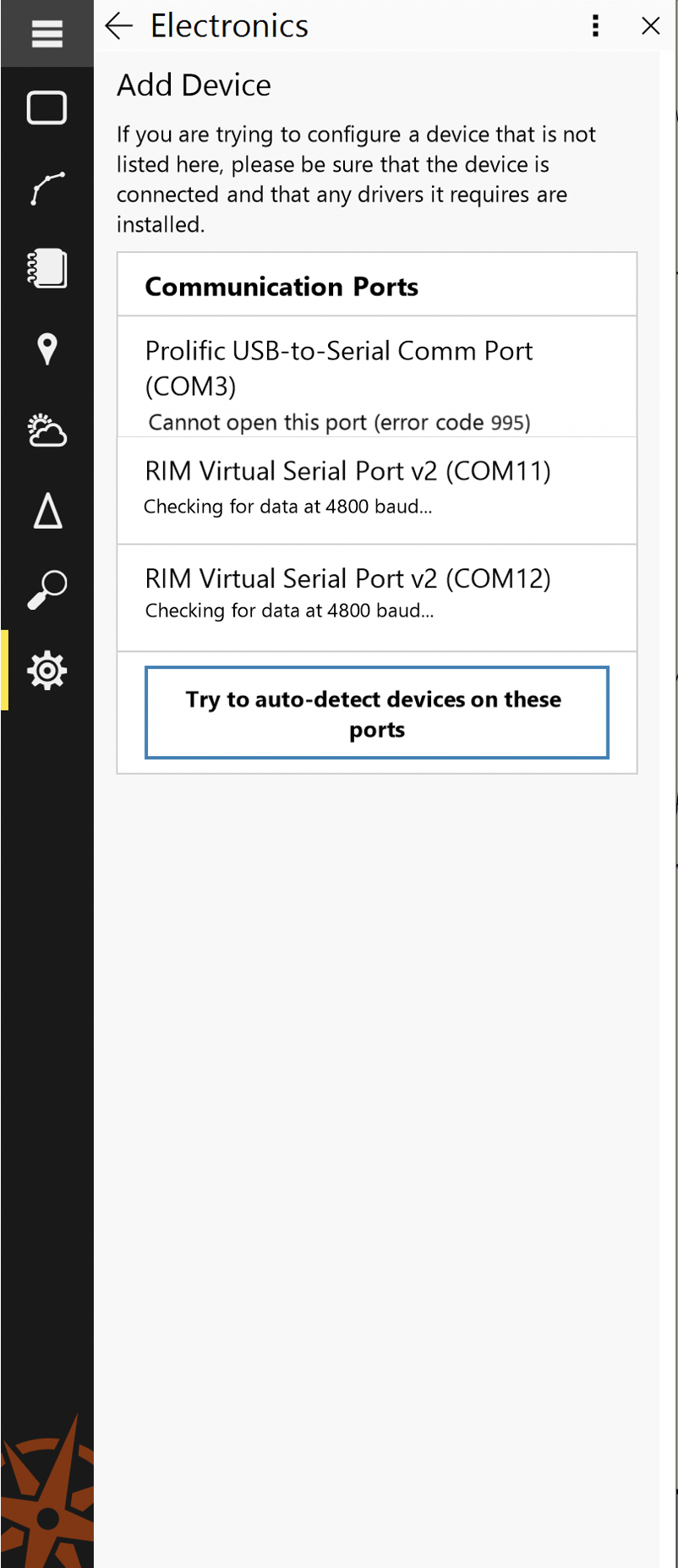

No COM port exists to configure
The illustration above shows how the Add Device panel will appear if there are no COM ports to configure. Immediately below the “Add Device” heading, you would see a list of any COM ports that could be configured. Since there are no COM ports available, we show the text starting with “If you are trying to configure a device that is not listed here…” instead, indicating that one of the most common reasons you may not see a COM port is due to drivers not having been installed for the device you’re trying to configure.
In order for a COM port to appear here, Microsoft Windows must recognize the device and any drivers associated with the device must be installed. If both of these are true, you should see a COM port listed. The steps below will help ensure that you have done everything necessary.

Error 995 during automatic detection
Automatic port configuration is a helpful tool but may not always work reliably, depending on the driver software for your device. If you do receive this error for a specific port when using our auto-detect (the button labeled “Try to auto-detect devices on these ports”) feature, trying a couple more times will often work but, if not, manually configuring the port usually will. Read the help built into our software and watch our video Configuring Electronics on how to do this. As indicated in the video, it will be useful to know what baud-rate your sensor is using, since the baud-rate you choose when configuring the COM port must match the baud-rate of the sending sensor.

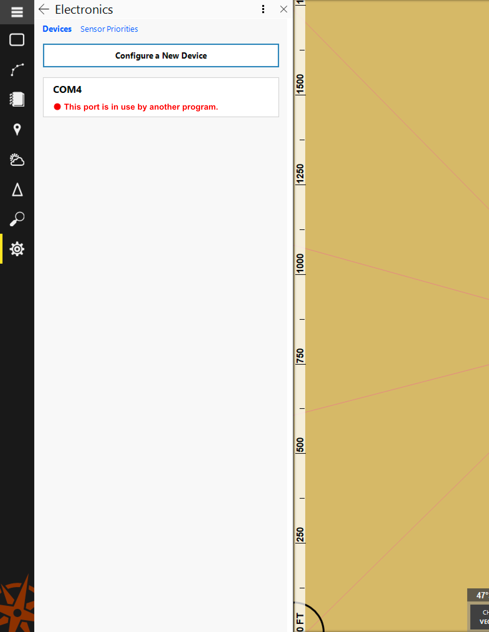

This port is in use by another program
Typically, this means one of two things:
  • The COM port is being used by another program. Microsoft Windows will not allow more than one computer program to have a given COM port opened at the same time. If you wish to use a COM port in Rose Point ECS or Coastal Explorer, make sure no other programs are using it.
  • Windows itself may have the COM port opened. Windows can sometimes mistake the serial signal coming from marine electronics, such as a GPS, for an old-fashioned Microsoft Ballpoint Serial Mouse. This is often accompanied by the mouse cursor on your screen moving around on it’s own, in a random fashion. This is usually referred to as “Crazy Mouse.” We have a different article that provides steps you can take prevent Windows from looking for these old mice. Performing those steps should stop “Crazy Mouse” on all your COM ports, thereby making that COM port available for use in Rose Point ECS or Coastal Explorer.

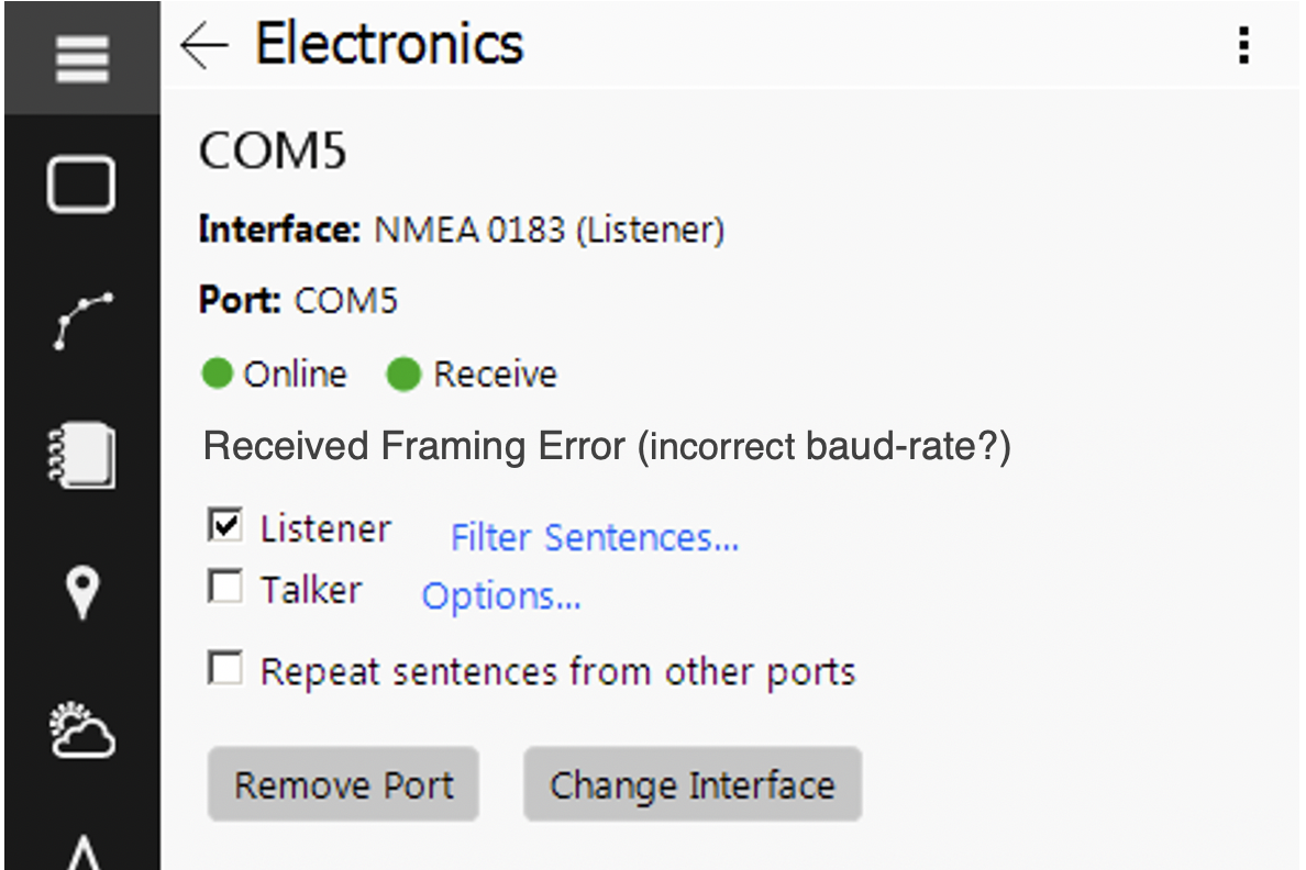

Framing Error (incorrect baud-rate?)
Although there are several possible causes for this error, it is usually due to setting an incorrect baud-rate when manually configuring a port, or changing it’s configuration. The baud-rate must be set to match the baud-rate of the sending device, so make sure you know what this is and match it. Consult your instrument’s manual to determine the correct bad-rate, or use our automatic configuration tool.

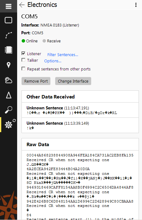

Corrupt data being received
Corrupt data can be caused by a couple of different things:
  • Incorrect wiring between your sensor and the connection to the computer, such as a USB Serial adapter: If there’s a problem with the wiring, have a qualified marine electronics technician come onboard and fix it. Incorrect wiring doesn’t necessarily mean miswiring since, depending on how it was miswired, there would simply be no data, but it’s also possible that there’s a lose wire, or bad solder joint involved, or even a cable that is too long, causing too much voltage drop by the time it reaches the computer.
    • The easiest way of determining whether this is the problem is if we are receiving some good data and some bad. The easiest way to spot this is by looking at the NMEA 0183 Sentences Received list. If you see a growing list of Unknown Sentences, this is likely to be the problem.
  • An incorrect baud-rate was used when configuring the COM port: Typically, when using an incorrect baud-rate, you will recieve a “Framing error (incorrect baud-rate?)” This error is covered in a previous heading, so consult that on for possible solutions.

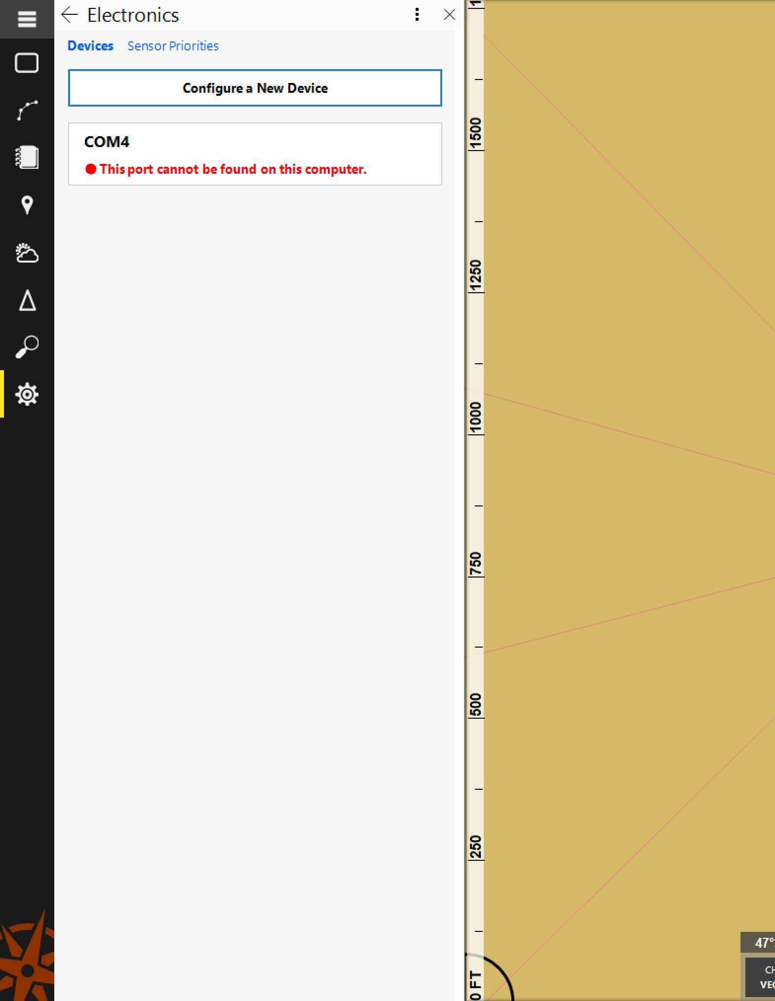

This port cannot be found on this computer
There are a couple of possible causes for this:
  • The device, usually a USB Serial adapter, isn’t plugged into the computer’s USB port: If you’re getting this error, it must have been properly plugged in in the past, or you wouldn’t have received this error. If it is plugged in, make sure there isn’t a problem with the USB port itself, or a failure of your USB device.
  • Some USB devices, such as certain brands of portable GPS sensors, and USB Serial adapters, will be assigned a different COM port when plugged into different USB ports, which can cause this problem: See the heading below titled “COM port number has changed (Prolific chipset)” for more on this problem.
